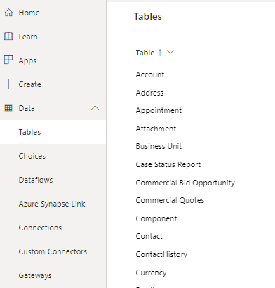

    I am trying to look into some field attributes in make.powerapps.com for the Cases table, but I do not have it.  Shouldn't this be automatic since Cases come out of the box with D365 CE?  What happens if I add it?  I normally use the classic interface (I know, that so old school) so I am trying to learn the new form editor and was surprised that it wasn't there.  Some of my new entities are there, and I see some like Account, Contact, Email, etc.  Any help would be appreciated.

    I ran into this a couple of iterations ago.  Turns out you have to update the filter in the upper right from Default to ALL in order for the Case table to display.  You can also access the Case Entity/Table directly from the App and click the pencil to edit.
    I hope that helps!

    Excellent, that worked!  Lifesaver!!
    Thank you!
