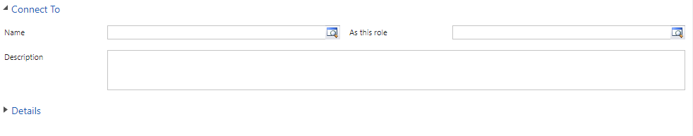

    @Ryan Nallen - With the Site Record open, click the "Connections" option from the Related Records menu. You will see a sub-grid appear with a "Connect" button in the corner. You can then select "To Another" or "To Me". You will need to click on "To Another".
    A new window will appear to help create the connection to another record. Referencing the below screenshot, the Name field is a lookup field to other records in the system. By default, it lists the Account records. However, you can choose other record types (entities). At the bottom of the lookup list, click "Look up more records", then change the first field from Accounts to Contacts, then search for the contact you would like to connect to the Site record.
    The field of "As this role" defines the category, so to speak, for this connection. New Connection Roles can be added, if needed.
