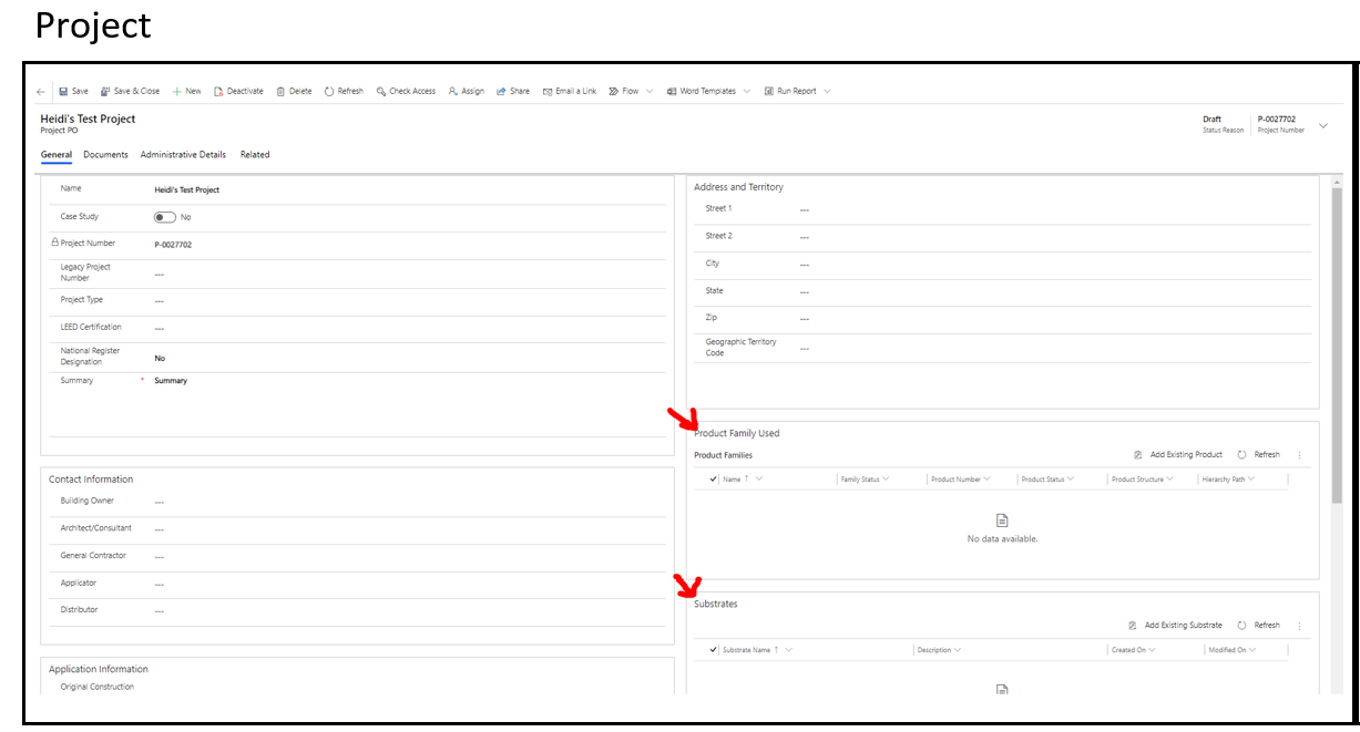

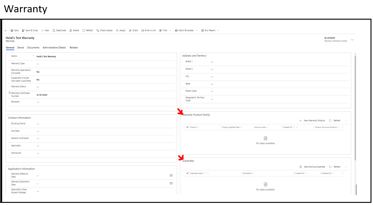

    You mean I would need to add new fields to my Project form?  I'm confused because the sub-grids already exist there, I just need to copy them over from the Warranty record into a new project record.
    This is the flow I have built so far and everything works perfectly.  But now I just can't for the life of me figure out how to copy the sub-grid information over.  I am really stuck on the next step in my flow.  I tried about a dozen different things yesterday before giving up!

    @Heidi Wylie - to show the right data in the subgrids is all about the datamodel underlaying the form. In the first form there seems to be a parent-child relationship from Warranty to Warranty Product Family and to Substrates. That means there is a lookup field in the Warranty Product Family and the Substrates table pointing to the Warranty table.
    From the second form it is not clear to me if the same tables are appearing in those subgrids or if that are different tables. If it are the same tables then there should also be a lookup field in those tables, pointing to the Project table. If it are other tables then you should look in those for the lookup field.
    For your Power Automate flow and populating those subgrids:
    - after you create the Project record, you need to retrieve the Warrant Product Family records that are linked to the project. Use a 'List' action. I always use a fetch-xml statement in here that contains the retrieve-logic needed (export an advanced find to fetch-xml or build it in the xrm toolbox).
    - to process all the retrieved records you need an 'Apply to all' loop. This loop will automatically be created if you put an action in that uses a field from the list-result.
    - in the apply loop you have to put in an update or a create action to link the children to the Project record. When your children are already existing records that now also need to be linked to the project record, you need the update action. If it are completely new records, you need the create action.
