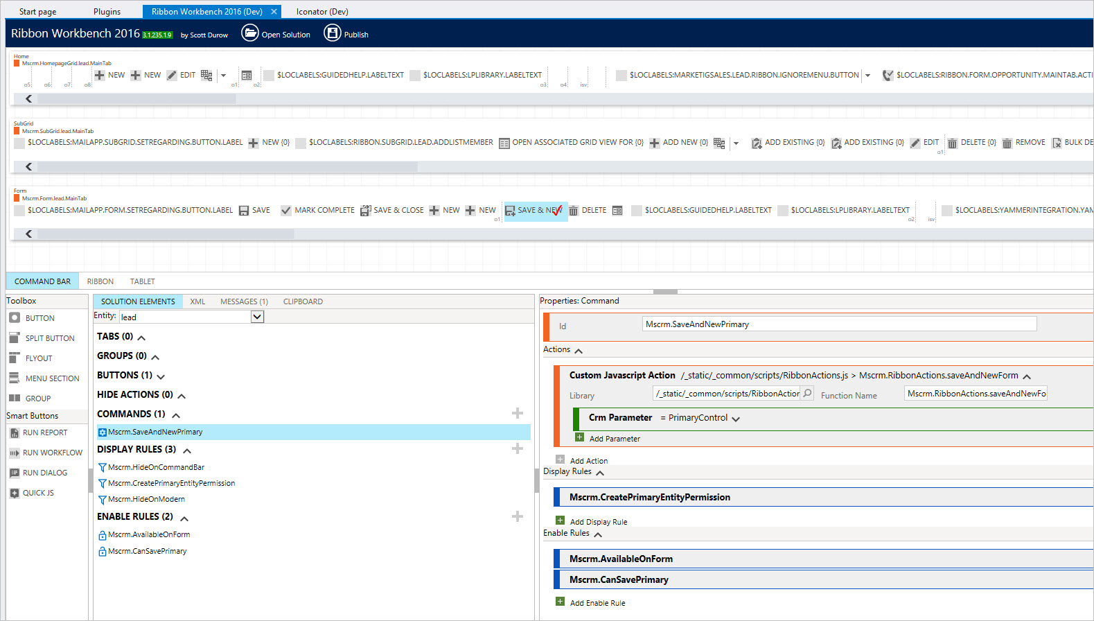

    Using Ribbon Workbench in XRM Toolbox, I was able to enable the Save & New button, as described in https://www.cobalt.net/2018/03/26/save-new-button-go/
    However, it just does not want to work in the UCI. It shows up fine but is totally unresponsive.
    Does anyone have any ideas?

    ​​Save & New button will not be working in Unified Interface anymore (unless Microsoft add the support to it) because the Save buttons are referencing to the new JavaScript library Main_system_library.js instead of the old RibbonActions.js.
    And in the legacy web client, the form seems to load both libraries so that "Save & New" button was working.
    In the new JavaScript library Main_system_library.js, only 3 Save commands are available
    • saveForm
    • saveAndCloseForm
    • saveAsCompleted
    Patrick's custom JavaScript web resource solution would be the only solution.
