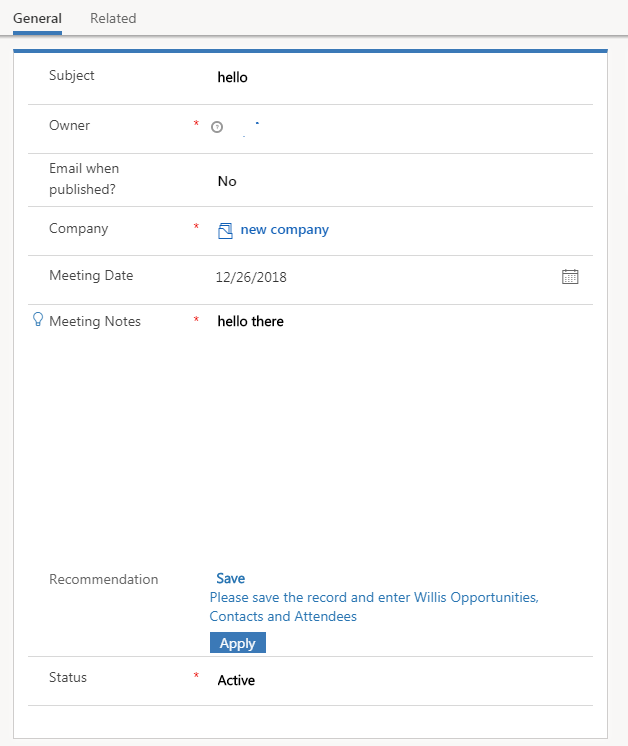

    ​Hello Team,
    We would like a notification to be shown to the user when he enters all the fields on the form . This notification would say "Please save record to enter more details. We have been able to achieve this using Business rules
    form
    It works all fine . We wanted to know if there would be a way to save the record when we click on "Apply" . As we are building a new system we would like to avoid any code and we wanted to understand if we can do the same using business rules.

    Thank you for your reply. We get the "Apply " button when we use a recommendation in a business rule . The recommendation asks us for an action to be added with it. This action is mandatory to complete the business rule. so  once when a business rule runs successfully the action gets applied using the "Apply" button.

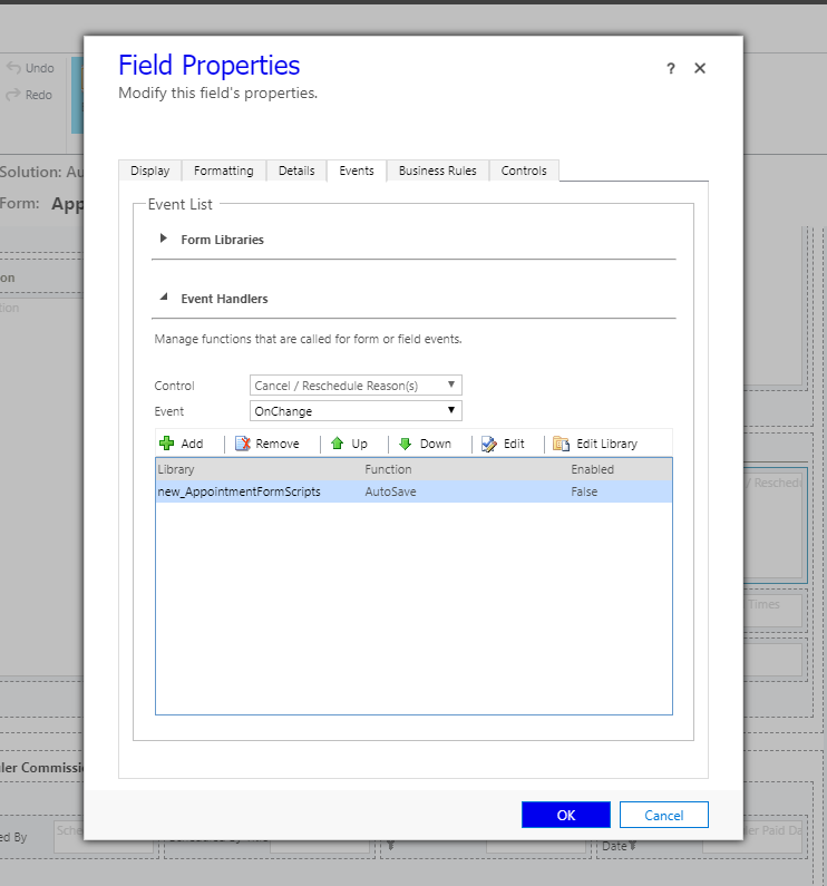

    You can just connect it to the field OnChange event.
    Open the form editor > Selected field's Field Properties > Events tab:
    Event Handlers in Form Editor
    In the Form Libraries is where you put the actual code. These are saved as web resources. Note: You will need to publish all to ensure they publish.  They do NOT automatically publish when you publish the form as they are a separate system component.
    Once you've added a javacript web resource in the Form Libraries section, you can add the event handler, as shown above. This will execute the code whenever the specified event occurs.  In the case of the suggestion, if the user clicks "Apply" it is effectively allowing the user to change the field value, which will trigger the event.  You may even be able to just get rid of the recommendation as it will save automatically.

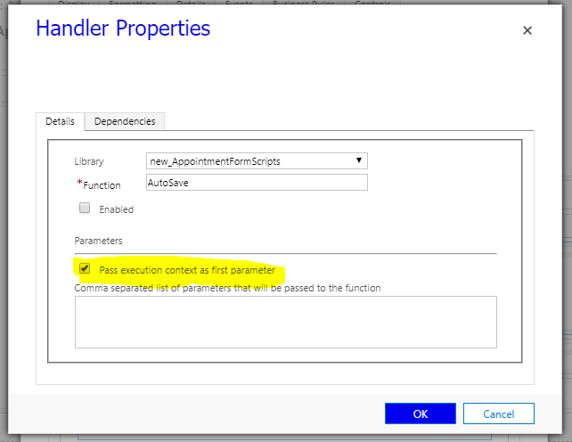

    Also, under the pre-version 9 model,  the code would have just used Xrm.Page to reference the form for executing the save function. You didn't need to pass the execution context to it.   Under the new model, this has changed a bit and I over-simplified a bit based on the old model. Under the new model, you now should pass the execution context to your function and get the formcontext from that. Here's how:
    You should pass the execution context.
    The code receives the context and references it:
