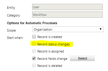

    Use Case: We have a leads assignment rotation which queries a list of custom lead assignment allocation records to determine which leads can be assigned to which users. When a user's title or status is changed, we'd like to have a workflow automatically check if they are still active, if their title contains "consultant," and deactivate the related lead assignment allocations if appropriate.  Unfortunately, unlike most entities, the trigger for "Status Changes" is disabled on the user entity.  Status is also not listed in the list of fields under the "Record fields change" option.
    User workflow triggers don't allow a workflow to be triggered against a user based on status change.

    You would need to use a plugin to perform this function unfortunately. I think with the status change now controlled by licensing, this option has been removed. Some have suggested trying an async workflow, but I don't expect that to work either.
    One option might be to try setting this up as a Flow, I haven't tried it personally but worth a shot to see if you can get the desired result.

    There is a field called isdisabled that you might be able to use to detect status change.  I've never tried using it as a trigger, so I'm not positive.  I use this field as a filter test for views instead of trying to decipher status codes for SystemUser.  Hope this helps.

    Thank you both for your input.  Given the relatively low frequency of edits to user records, I think we're going to just have it fire on Modified On.  Of course the first step of the workflow will check the isdisabled and title fields. ​​
