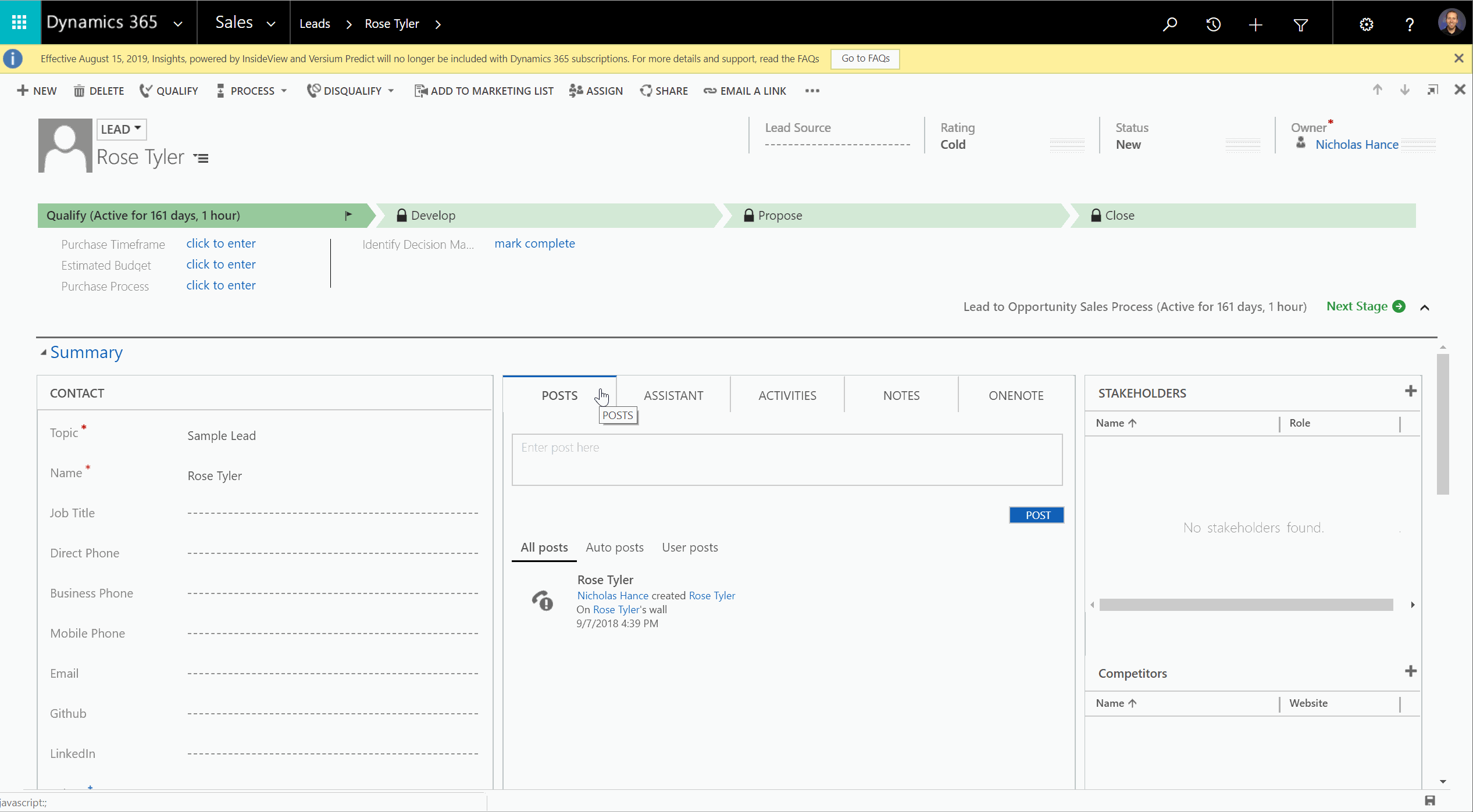

    Happy to help with the tool!
    The two options you mentioned didn't look like they'll work but I did find another option. You could insert an IFRAME into the form that shows everything from the audit page. This would then load all of your details in a small area.
    Here's what you can do:
    - Visit a record of your entity type
    - Open chrome inspector (Control + Shift + J)
    - Visit the audit page, grab the iframe source url
    - Use this iframe source url to build a string that you'll need to update with the id of the current record
    - Change the src attribute of your iframe in your form via javascript, substituting the current record's id into the string you made above

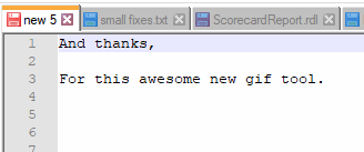

    Wait, Tangent, but what tool are you guys using to make the GIFs?  Looks simpler than recording a video and converting.
    Ryan Perry
    Auric Solar

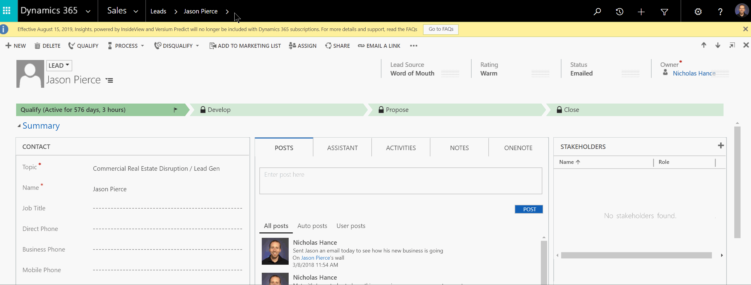

    You can add it on the left side of the form editor and it'll appear up top
