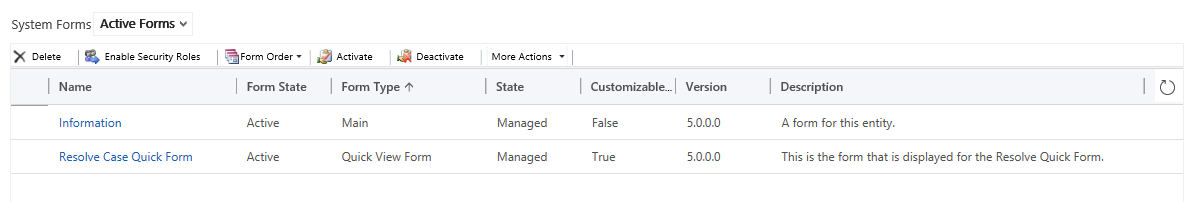

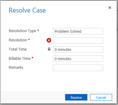

    I've read many posts and blogs which state that you cannot customize the Resolve Case form which I'm finding difficult to believe given how restrictive this form is out of the box. When I open it in editor, it does in fact have a false status for customizable. My questions are:
    1- Has anyone done a workaround to customize this form?
    2- In the absence of the ability to customize this form, what other options have other organizations pursued to give a more customized feel to the case resolution process and form input?
    3- How would you instead access the Resolve Case Quick Form?

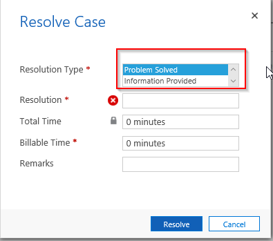

    4- Where can I enter other options that I want in the drop down for Resolution Type? At present the 2 options simply are not enough for what I want.

    1 and 2. This form is not customizable in supported way. The only way you can use is to hide standard button and create custom that will show your custom dialog using Html/Js. Check following article that can be helpful:
    Here is how to customize button - https://butenko.pro/2013/01/13/ms-crm-2011-how-to-override-standard-dialogs/
    Here is how to create Html/Js dialogs - https://butenko.pro/2015/03/01/howto-htmljs-webresources/ and https://butenko.pro/2014/06/13/dynamics-crm-2013-step-by-step-creating-dialog-windows/
    3. There is no need to access it.
    4. Resolution Type you can change customizing Status (statuscode) field.

    I echo Andrew's reply - you can update Status field to select different resolution types.

    I agree with the comments and would add that the text boxes provided for resolution and remarks are ridiculously small.
