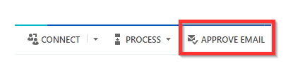

    Is there a way in Dynamics 365 to automate the "Approve Email"  and  "Test & Enable Mailbox" steps?  When a new user is on boarded to CRM, we manually have to Approve Email and Test & Enable Mailbox for each user.
    Would like to know how we can automate these 2 steps.
    Approve Email
