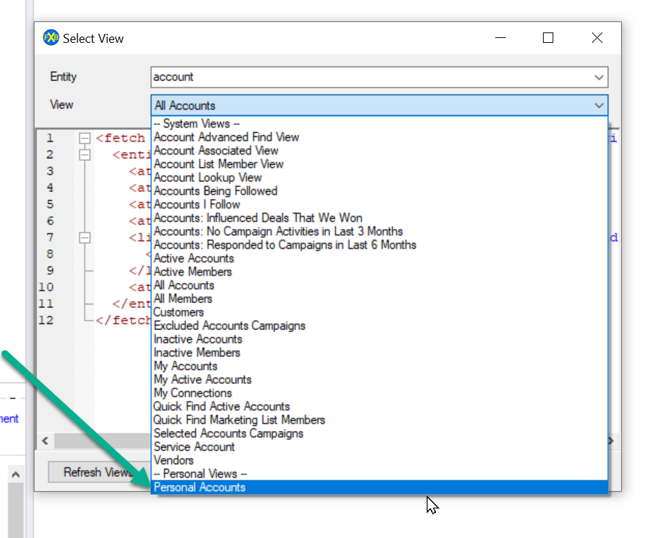

    Well actually anyone - if you have any problems with FetchXML Builder. That link goes there :)
    If you have problems with View Layout Replicator here: https://github.com/MscrmTools/MscrmTools.ViewLayoutReplicator/issues/new
    Or easiest from the XrmToolBox like this:
