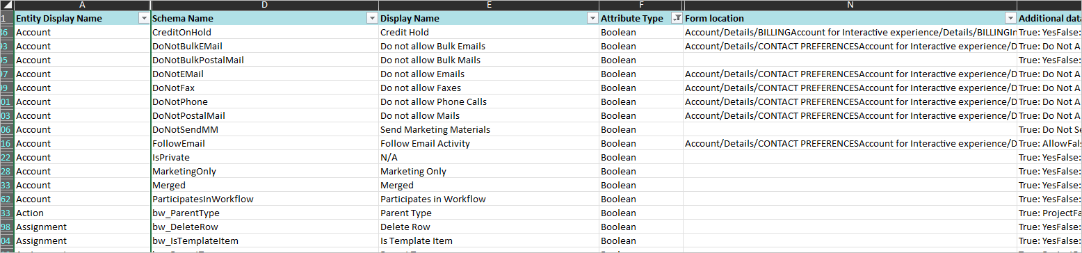

    One way that you might find which forms it is used on is to check the forms that have a Yes/No - if you use the Metadata Document Generator in XRMToolbox, it includes a setting to say which fields are on which forms - this won't tell you if the Flip Switch is used but it will narrow down the search field a little, if you filter on Booleans.
