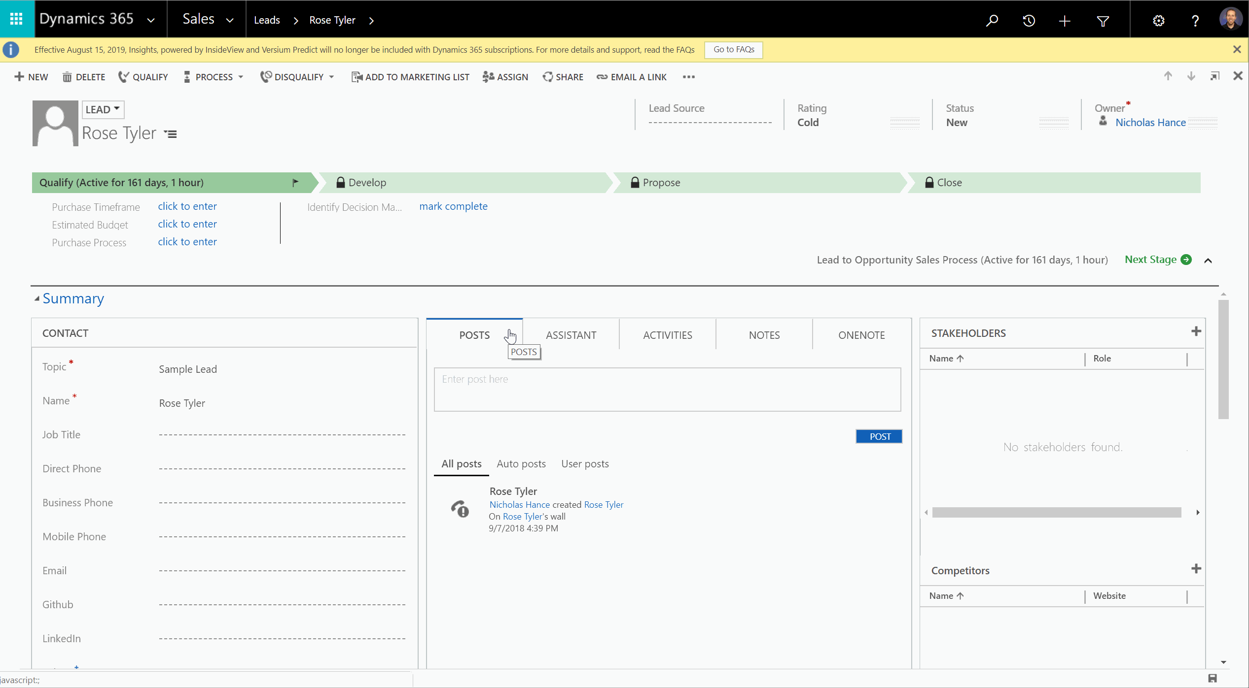

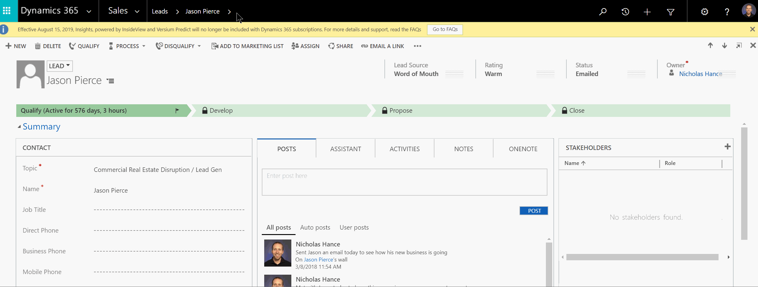

First, let’s look at what we’re inserting. Our view of the audit history will be the same view that you see when you select Audit History from the Form Navigation. If you’re using v9, it looks like this:
Now that we’re on the audit history page, let’s take a closer look at how this is displayed. If you use the Developer Tools for your browser, you’ll find that this view is shown inside an IFRAME which is how a lot of the components in Dynamics are displayed.

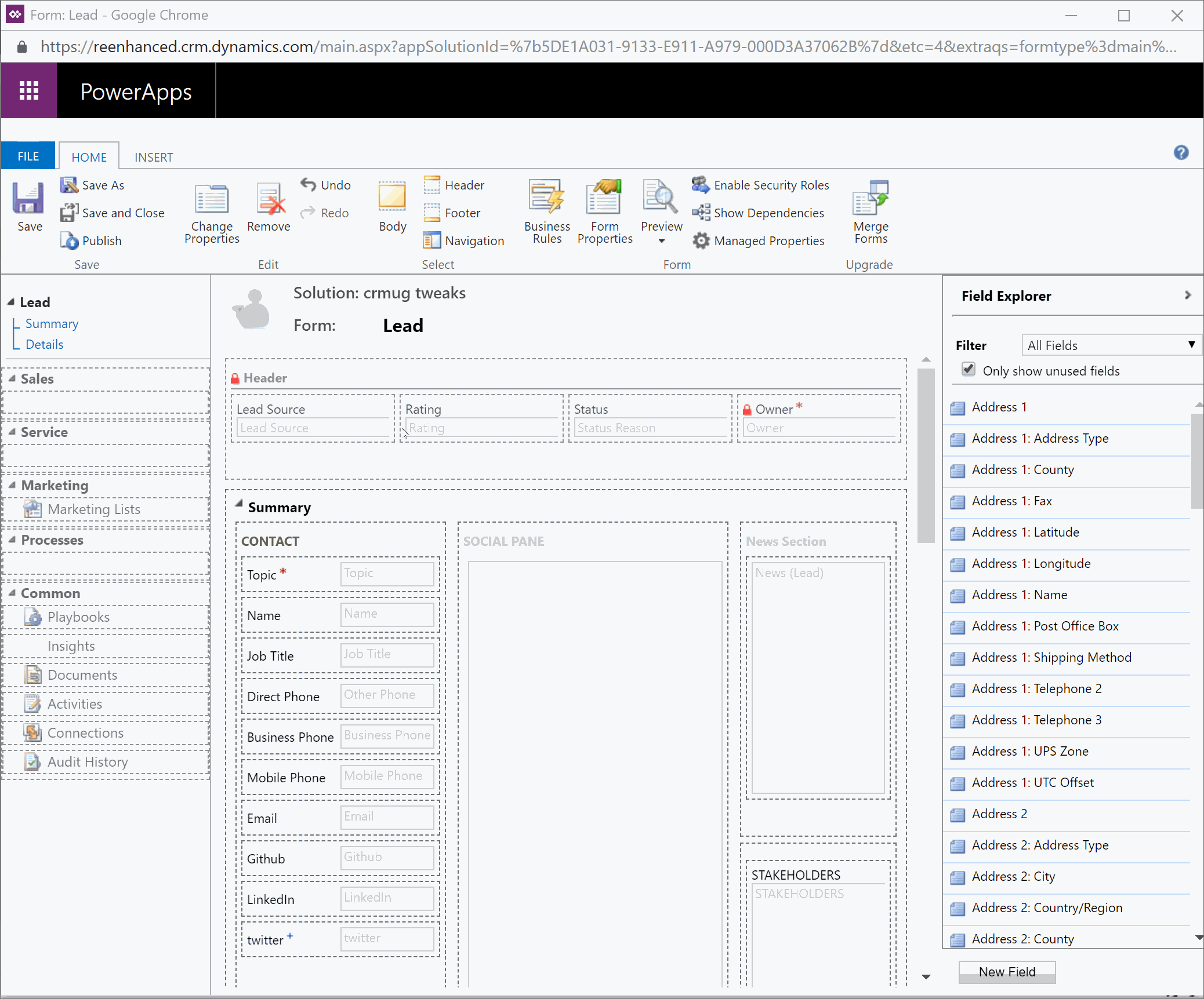

Once you have your file, save it to your local machine. The next step is to upload this into your entity form.
In our example, we add a section to the bottom of our form that will hold the Audit History because this component requires a lot of space to display.
Some things to note when you do this:
  1. Mark the Web Resource type as HTML so that Dynamics knows the right way to display it.
  2. Make sure you click the box inside Web Resource Properties to Pass record object type code and unique identifier as parameters. The script uses this to know what audit records to show.
You can reuse the script above to display any iframe you like into any entity form, all you need to do is change the element.src property.
